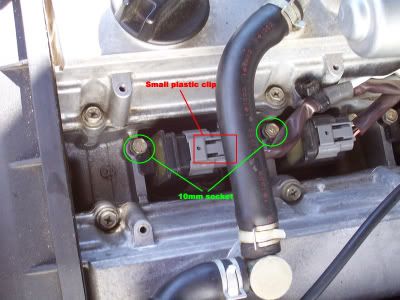

Step two: Unclip the small plastic plug on the coilpack by pressing down on the clip and pulling the whole plug out towards the windscreen of the car. The clip should pull out easily.
Step three: Undo the 2x 10mm bolts.

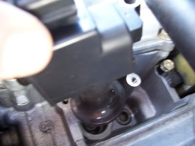

Step four: Once the bolts and the clip is unpluged you can now remove the coil pack. This is simply done by pulling it straight up. It should come out easily, if not don't use excessive force.
(Below is a photo of the coil pack)
Step five: This is what the degreaser is for and the cotton buds. Spray a very small amount of degeaser onto a cotton bud and clean up any grease, dirt, grime that you can see. Use the compressed air gun to get rid and losen any grime or dirt, then use the rag to clean up just to make sure.
