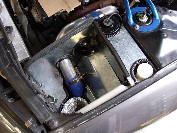

so, did you open up smic return pipe hole to 125mm and fed the ducting to the cold air box?
BADHAB|T
  • Posts: 4843
R32 Cold Air Box - DIY
« Reply #20 on: December 24, 2010, 05:29:27 PM »
This should answer your question sonoramicommando
(pics coming in a tick) :)
BADHAB|T
  • Posts: 4843
« Reply #21 on: December 24, 2010, 05:37:43 PM »
As I said at the top, I wasn't completely happy with the job.... in a way it looked unfinished so I made a few extra pieces to try make it look 'finished' :) (I'm still not totally happy with one piece of metal I cut too, but its hidden by the POD :D ) I'm completely out of sheet metal now anyway, so I can't remake a piece unless I get more metal and thats well and truly in the 'too hard basket' for now!
I cut a piece to fill the rest of the bottom of the box
Here it is fitted
I also made a piece to fit between the back of the box and the suspension tower. Its just covering some wiring, but I reckon it looked odd having a hole/random space there.... so I filled it
(no pic sorry, it somehow didn't turn out very clear :\ )
Here are both new parts fitted without the POD in the way
Finished product
« Last Edit: December 24, 2010, 05:57:23 PM by BADHAB|T »

yep thats nicely done - and answers my question too.
i've cut up a rectangle hole at the bottom of the stock airbox and laid up glass cloth to make up a rectangle ducting to face down. i thought about making a 90 piece so air rams in but then i was rather worried about hitting puddles and all (plus it would be a lot of hassle to line up the ducts) so didnt bother. But sealing the gap between the hole and the duct with the boot trim, i definitely gotta do.
