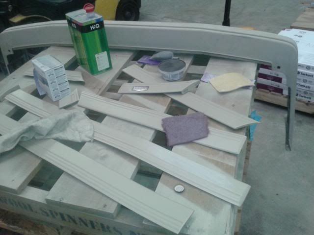

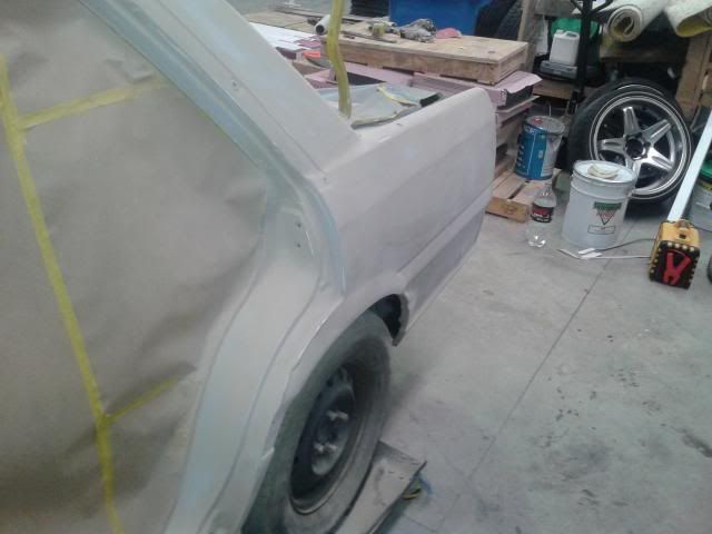

last of the panel work is finally done and im doing all the parts now bumpers,trims,ect  paint will be going on this weekend bar the engine bay still few little  things to do there
its looking pretty straight now so hopefully will be the last time I sand this thing haha ..

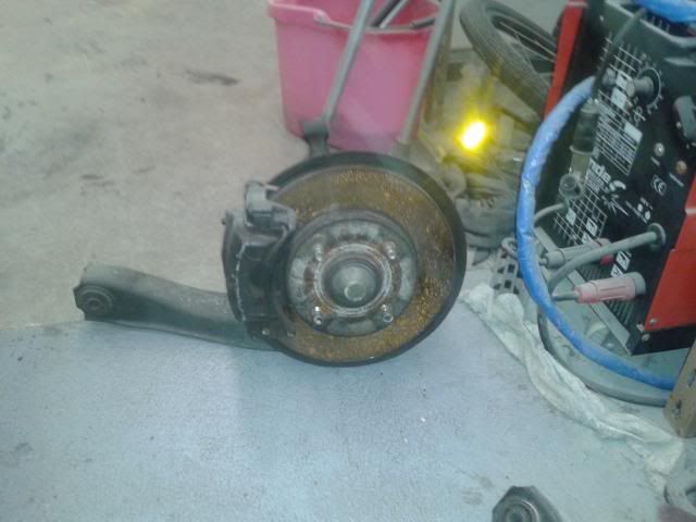

got my brakes sorted there off a s13 ca18det and are floating hub as mine were not getting some slotted rotors and better pad just for the front  got lcas and knuckles hubs and rotors for pretty cheap which means now theres lots more options for suspension knuckles ect ive got a set of adjustables on the way to so that's that part of the car sorted just ecu and wheels left now...

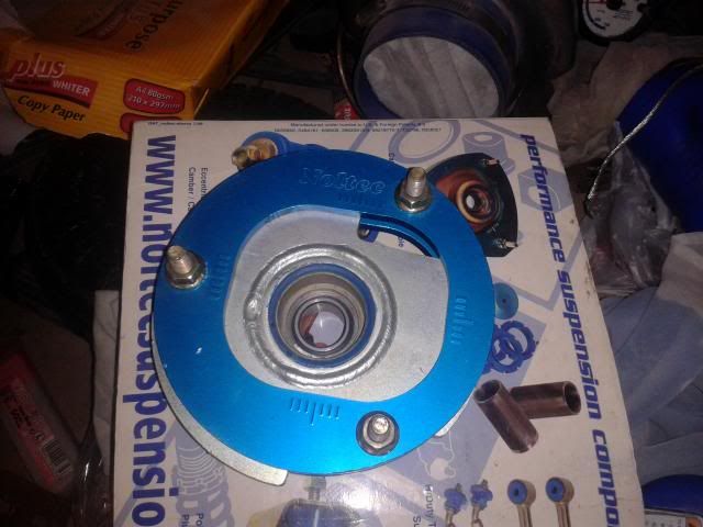

got these as the adjustables  don't have camber plates on the rear set  so this will do for that....got these brand new in the box a bunch of silicon joiners and some nice black speed flow fittings and a oil pressure warning light for 100 bucks so couldn't complain about that

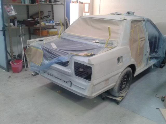

so had a busy night the night  before my birthday setting it all up hanging parts and stuff but we got it all done and ready to be sprayed the next day..
woke up the next morning hung over hoping nothing had fallen down overnight hahah but it was mint then my mate got here and we started laying on the paint bloody water trap on the compressor was playing up so theres a tiny bit of crap in the paint but I still have to buff it and clear it so it will all come out
so just have a few more parts I will get done this weekend bumpers and stuff but I can start putting it all back together now shouldn't be to far away now as im starting to put all the door cards/easy stuff  back on right now

look's good man,are you still going with the 25det? my brother has used the same brake's and lca's,i think he used r32 sedan tie rods because of the lca's extra length to make it work,im sure your aware of this tho. go-kart looks fun to,does it get sideways?

cheers man and yeah still going 25 for now will start building the 30 when the 25s all in and running and yea can get brand new adaptors from aus(garage 7 lots of good stuff for old r31s ) or else can use n14 pulsar tie rods/ or r32 wasn't 100% on r32s but its good to here from some one that's seen it done with them so now least I know that works too still waiting on the suspension to get here then all that can go in
