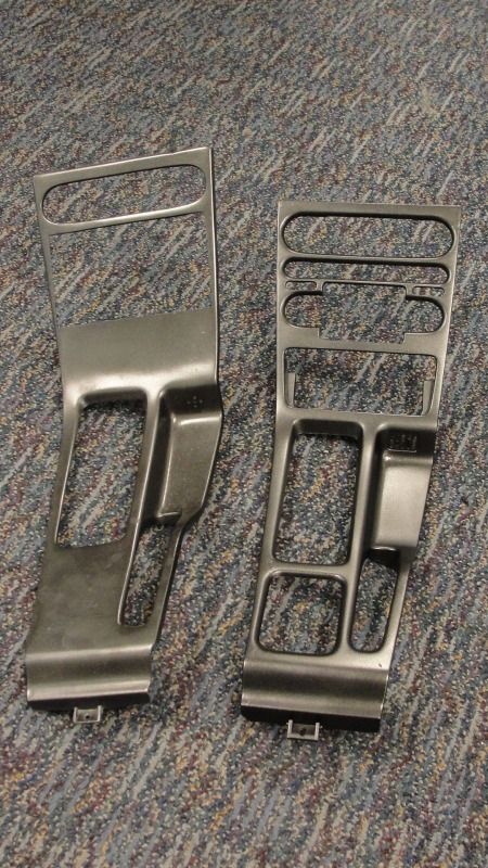

anyone here can recommend some places that can do modification to centre console ?
at the moment, the hole is only to fit 1-din unit, so it will need to be opened up so it can take the 2-din unit.
so obviously it will need some cutting, some epoxing, some grinding, some sanding and painting
this is the pic :
RHS is the FACTORY std one, and i want it to look like the LHS one for the 2-din unit
pointers ? suggestions ? recommendations ? etc ... much appreciated :)

image doesnt work, what type of car?

hi harley.. odd, the image is showing just fine in here.. it is for my honda

« Reply #3 on: January 14, 2013, 03:48:23 PM »
works now, take to it with a steady hand.
I Would contact honda, and spend both arms and testicles.

nooooooo.... i wanna keep my testicles so i can keep driving my nissan :D
but on the serious note, even if i wanna buy it from honda, there is none for the 2-din unit as honda has only ever made for 1-din unit :(

It depends how good you want it to look, if its in a nsx id be tempted to splash out.
Modify oem item, get mold made, make new item in plastic, or carbon fibre
Edit, or buy that!

i love carbon fibre, but it seems all the carbon fibre i see always ended up with white-ish/yellowish finish after a while - unless it's a dry carbon
oh well... i will keep searching..
it does look SEX though that CF console ... hmmm.... :)

I made this for my 33 last year....
made a mould off the original and laid up with 2 layers of CF.  Came out rather nice :)  It's not that hard either once you get started...

Frost what material did you use to make mould? And what brand of clear coat did you use?

very nice frost !! mustta taken u a long time to do those tricky inner curves. top effort mate ! :)

mould was made from normal old fibreglass and polyester resin.  I used packing tape to cover the original, one layer of gel-coat and then laid on the glass.  Once it set I bogged the inside, sanded and primered it to get a glassy finish.  Then wax and PVC the crap out of it and lay up into your mould!
Clear coat was out of a spray can if I remember correctly!  Just a lot of wet sanding :)

I wasn’t brave enough to do curves.. I made a flat piece of CF for mounting EVC display.
Clear coat spray can I bought dried to a cool yellow surface.. lol

ecozile... to be honest, i don't think i'm 'nutty' enuff to tackle this.... never touch this stuff before, so i think i will f**ck it up excellently :D

actually, thinking about it - it was 2K clear. Sorry.  I have used rattle-can clear before on CF and it has come out mint as well tho...
Happy to help out with local lads if they want to make up some CF bits.
