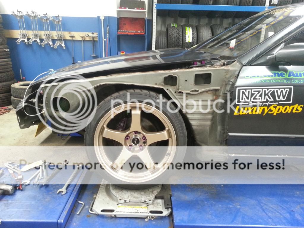

Wheel alignment today. Not sure how this is 8 degrees of caster but it's rubbing so bad at the back. Will need to do some panel modifications for clearance. 2mm toe out in front total, -6.3 degrees on side & -8 on the other so will need to adjust camber arm down to -6.3.

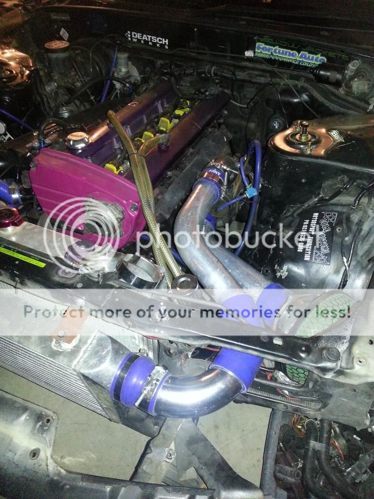

Bit of a new intercooler piping set up too. Looks nice & tidy with less bits in it. Heading down to Hampton tomorrow to put the old mans rx7 on the pad to see how it handles a bit of shit & will hopefully paint interior of skyline on Sunday.
