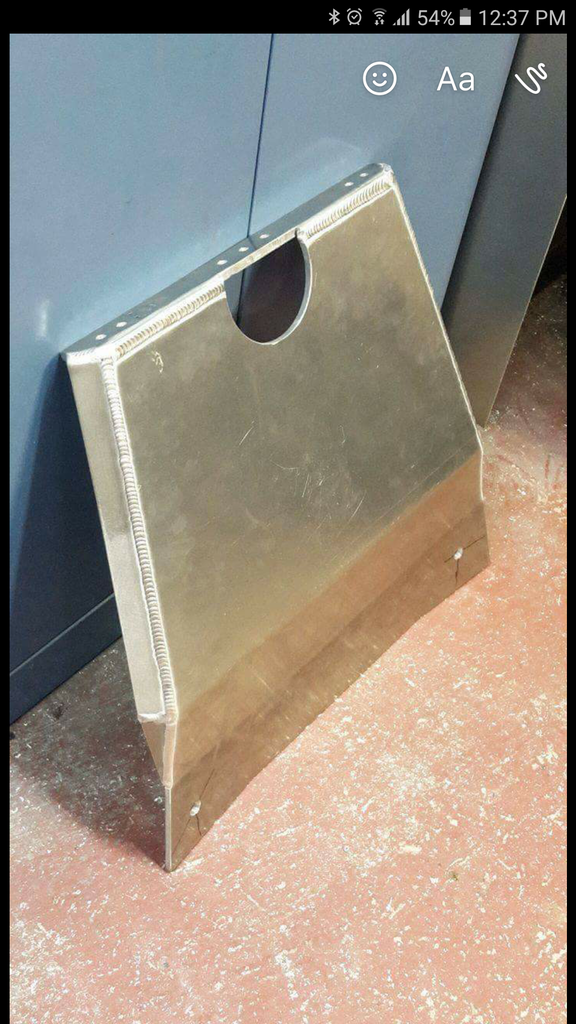

Have been pretty lazy with the car as of late, I did however manage to fit up the sump guard/bash plate that a friend of mine had made up out of 8mm alloy plate. This thing is SOLID haha, and not too heavy either, im guessing around the 8-10 kilo mark, but Id rather have it and not need it than the other way around.
It mounts to a 40mm solid alloy bar that bolts to the underside of the subframe behind the sump, which also gives me a solid jacking point I can lift the front of the car with, and then bolts to some box section steel I had welded into the castor arm mounts. along with some bits welded to its sides to prevent the edge of the plate catching on anything, this should hopefully protect my big sump from anything trying to open it up like a tin can haha!
Next up is sorting out the boot floor and new battery box, GTR bonnet, grille and headlights to go in. :)

does your sump sit very low? did you lower your engine on the mounts or do you just have a massive sump?

It sits reasonably low. Standard engine mounts/subframe etc etc. Car has had ride height raised a little since, but I put a wheel either side of the ripple strip when I spun off at the dipper on a drift school day and put a shallow dent in the bottom of the pan despite having a light bash guard, but the new one is waaaay stronger haha. Better off having it and not needing it. See below pic, hangs down below sway bar quite a bit.
