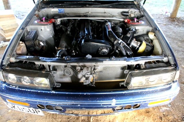

Had today off work so got stuck into it.
Fitted my radiator fans up on my radiator, then refitted radiator.
Cleaned intercooler body holes out a little more as pipe was close to fouling on the body, will fit door seal around the diameter of the holes to look tidier later in week.
Jacked front end up and noticed a slight oil leak, maybe from the rear main seal. Also noted complete stainless front pipe which is cool.
What isn't cool is the washers that are spacing up the a (?) arms so the front sway bar clears the sump. Will chuck a pic up in the next couple days of this.
Fitted up HKS intake filters and AFMs. Noticed the gauze was near poked on the inlet side of AFM, also think the old owners have just siliconed sprayed the **** out of the engine bay when they have cleaned it, because there is mass build up on the inside of the afm, not to mention the thick amount of crap everywhere in the engine bay.

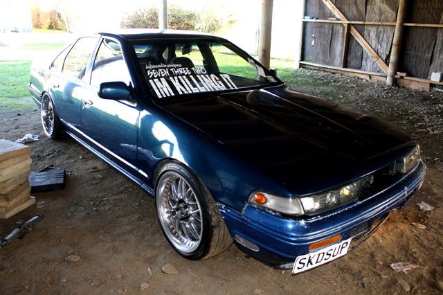

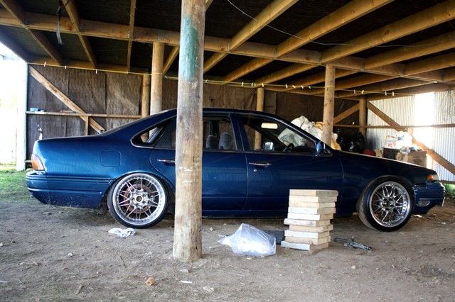

Got some new wheels, pretty happy with the fit, Work Rezax 18 x 9.5 +31 out back, 18 x 8.5 +31 up front, need some slip on spacers up front to clear the brakes. All tyres will need to be changed, going to go for some 215-30-18 all round i think.

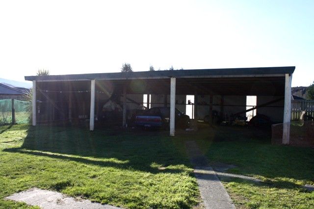

Like a boss 3 bay garage at home

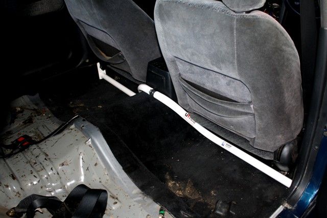

showing new ultra racing power brace

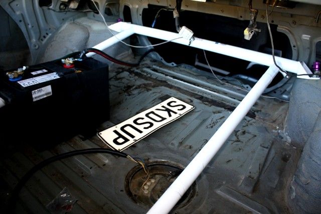

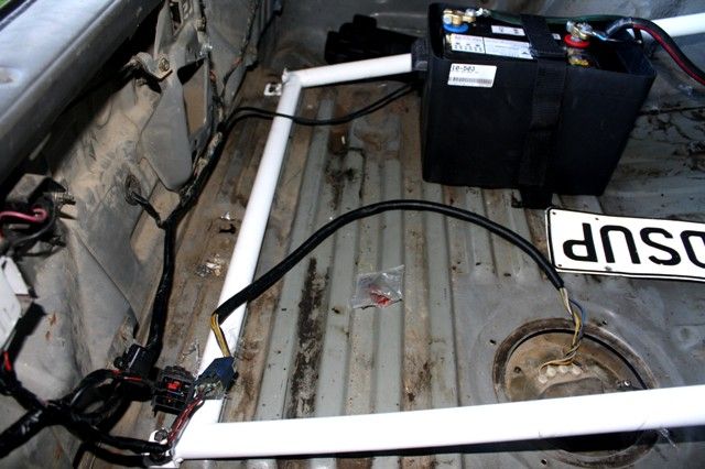

showing new rear 4 point ultra racing rear brace
mount points of 4 point rear.

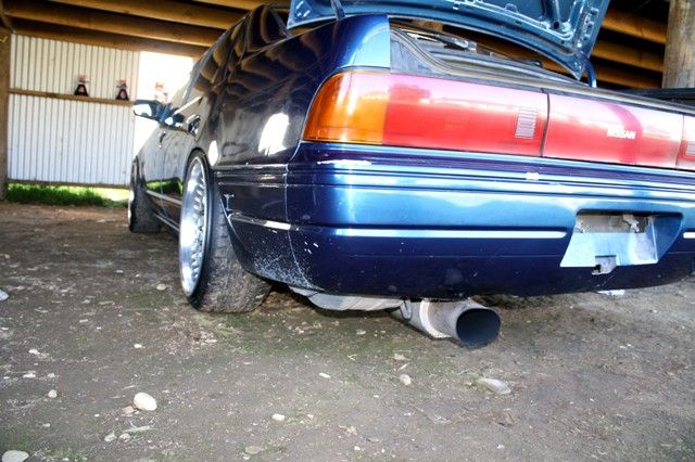

Will be removing back section of exhaust to flange by diff as rear muff is buggered, and will run a blast pipe for the haters.

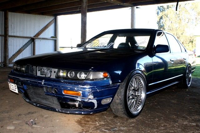

Have square headlights on the way form up north, stupid hard to find, to replace the ugly bulb circle style like every other cefiro on this land.

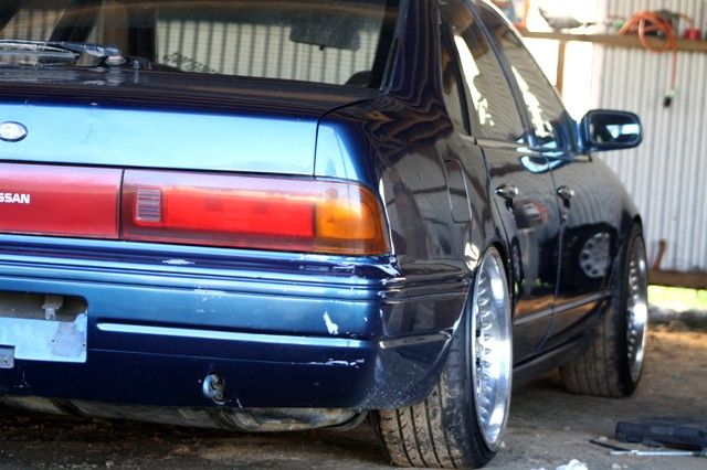

Dropped the rear suspension a little, but not really digging the fit, so will case some 20mm spacers out back, to replace the 8mm slip rings i have now, should bring it out enough to be happy.

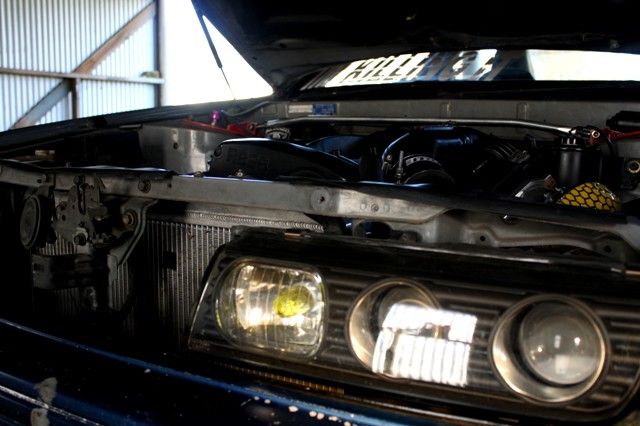

Got pretty busy last sunday on the car. Removed intercooler, drained radiator, pulled all wiring through guards.
Will take hot side off this weekend to get near dump pipes, then go for an unbolt after the bellhouse bolts have been taken out too.
Planning to paint the bay a wild as colour, my old laurel was bright green underneath, and looked pretty effective, so just running ideas through the brain at the moment on what colour.
Am going to replace all arms/crossmember up front as looks like its had a hit up front.

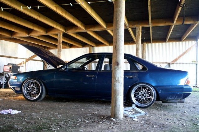

I put the 9.5" rezax up front for a look, and with the 25mm spacer it look spretty good. So when these came up on trademe, i couldn't help myself..
Had to get my mits on my rebuild money savings, but that can wait a little longer... 18 x 11.5 +19 work rezax, a little different style, and painted black face. Am going to send these wheels to Elite in Chch to get resurfaced like my 9.5"s, and pull the black off them too.
Pretty happy with the fit out back now, if a little mexican. Just bought a new guard roller, so a little rollout will help with that.
My headlights turned up, look great-alot better than most other circle style ones. Will work well with my new facelift bumper, facelift grille, heading towards my revised front end.
