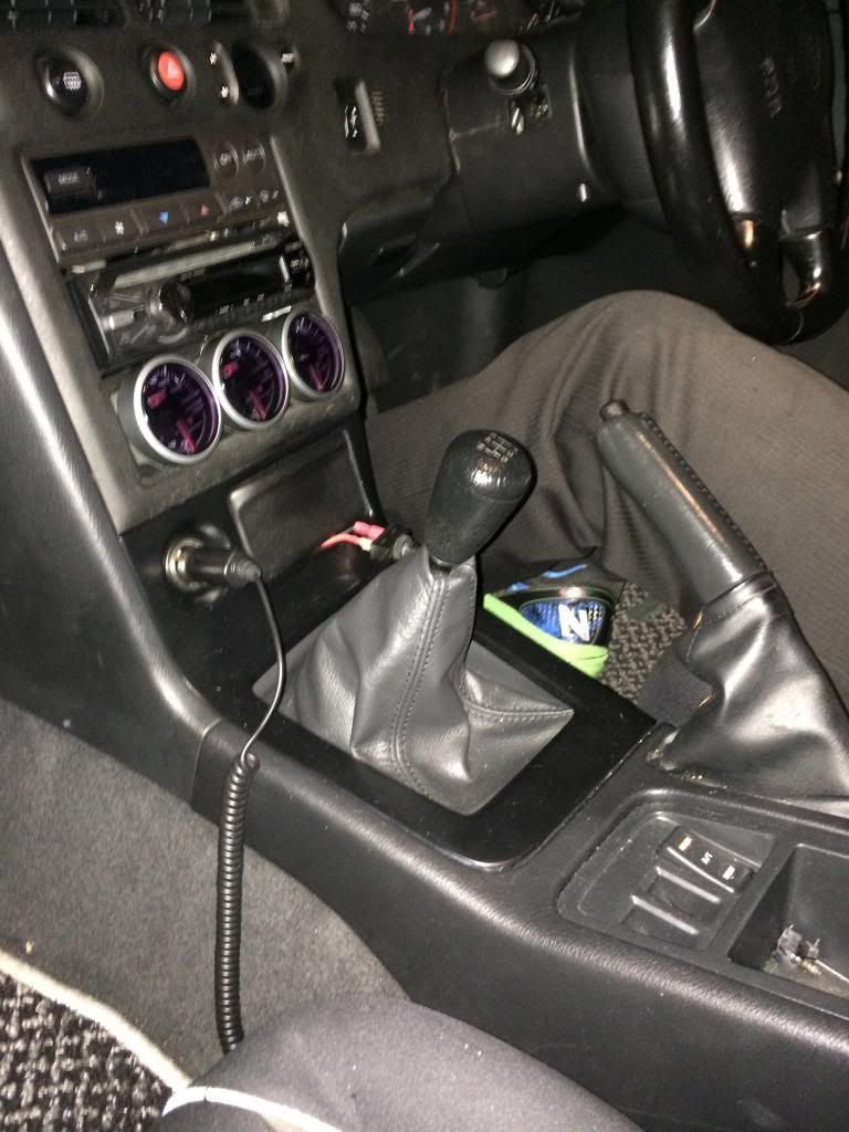

so few things have changed already, as planned manual conversion was pretty high on the priorities and has now been done with a full series 2 setup about 3 weeks after purchasing it :jack::jack:
Unfortunately the kit didn't come with any interior parts, so managed to pick up a cracked surround for 30buks and took to it with a soldering iron and some plastic from the old auto surround as a filler. sanded back and pained, looks all good,
have added a couple of gauges to rice it up :)

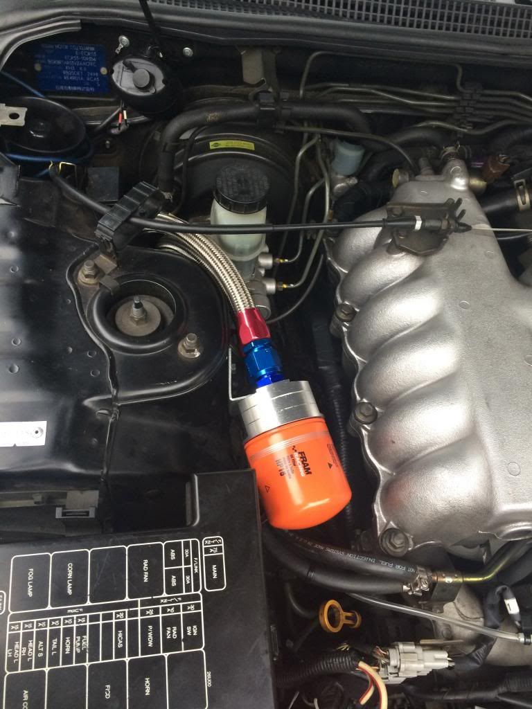

car is due for an oil change and have a oil cooler/filter relocation kit for it that I've had for a while, only problem is, I remember people mentioned something about a need to run a thermostat for these?
cheers

Yeah thats right, it is the best way to go about it as otherwise it will continue to circulate oil through the cooler and take forever to get to temp, if at all. However people will also run blanking plates over the front of the cooler to aid in the heating process due to not having a thermostat as well.

« Reply #11 on: May 15, 2014, 11:17:45 AM »
thanks man, how do they work? and where do I get one?
cheers

Haha ^^^. A blanking plate is a flat plate or cardboard piece in front of the cooler, thus restricting airflow so assisting with heating up the oil.

^yeap thats it. You can do it as simple as some cardboard type stuff or make some snazzy alloy thing its up to you. With the addition of a oil temp gauge you can work out whether the whole face needs covering, or maybe half etc.

Is it something that just screws in to the line from filter to cooler? and that brings me to another question, it wont matter which way i run the setup right? ie Motor/Filter/CoolerMotor or Motor/Cooler/Filter/Motor.
So in the mean time, oil change was completed today with Penrite 10W50 along with just the relocation of the filter, whilst gathering more info on thermostat for cooler. Actually looking forward to my next oil change now haha
finally got around to installing the manual surround thanks to my new leather boot arriving

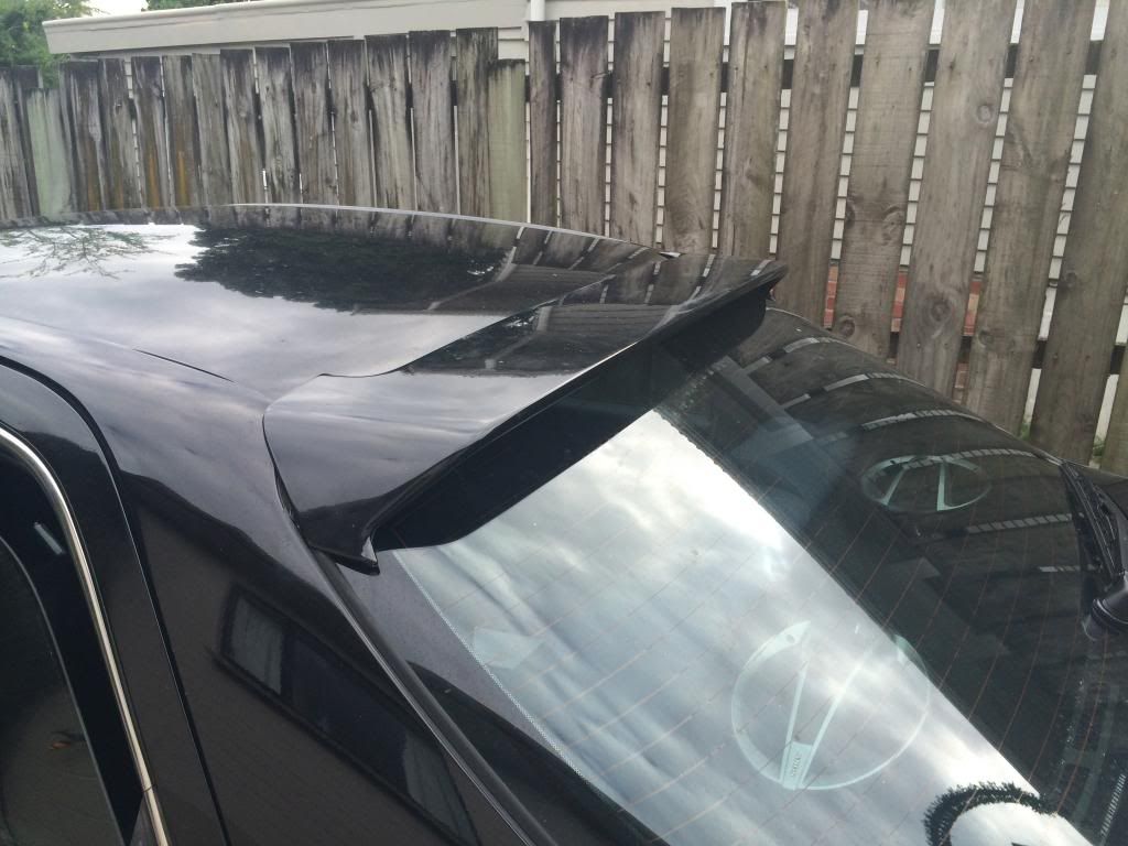

And was out at Zebra last weekend and picked up this spoiler that was just sitting on the roof of a civic :D looks like it was made for it,
until next time, feel free to comment :)
