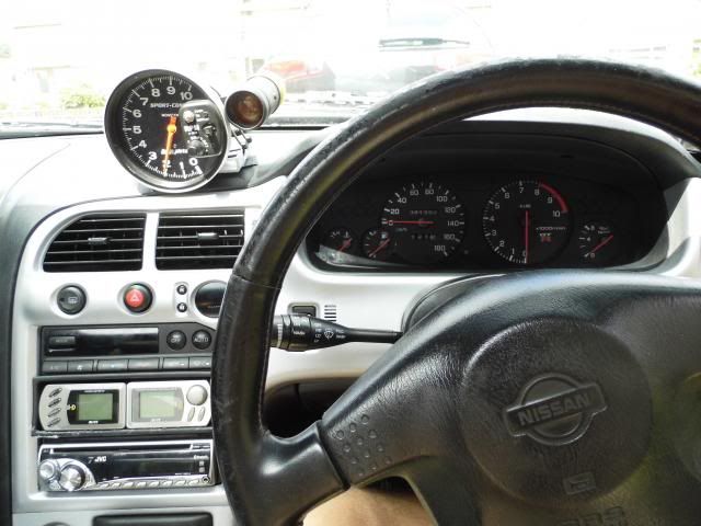

Boost Timer
Delimited and converted to mph
Sunpro volt and boost gauges
Razo pedals
Massive drift rev counter
