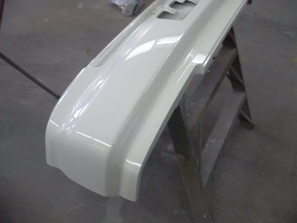

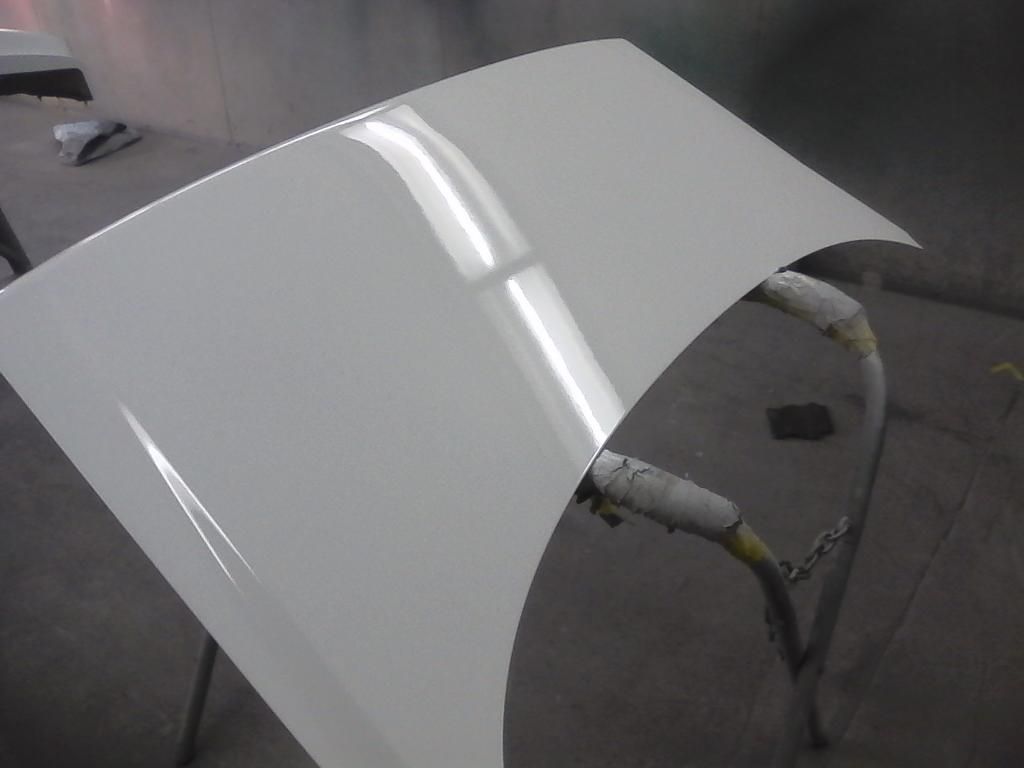

So here she is. Just recently bought it for a good price. 5 Speed Manual r32 box, rb25de.
Am doing all the cosmetic stuff first and so far have repainted the front bumper and painted the lip black.
I dont have photos of the bumper before but it was in pretty bad shape paint wise.
Cant decide wether or not to carry on the black lip with painting the skirts and the end caps. I think ill just leave it for now until I figure that out. The bonnet was also covered in shitty spray can white but i just gave it a trizact and buffed it up, will need a repaint though as ive gone through on a couple of the swages. Plan is to either plus t it or throw a 25det neo in it. But as always its money goverened so it happens slowly and she is also my daily so cant really afford to take it off the road for too long being 60 km away from home every day.

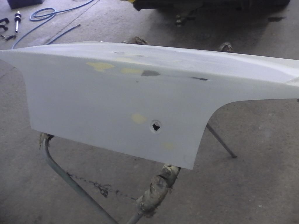

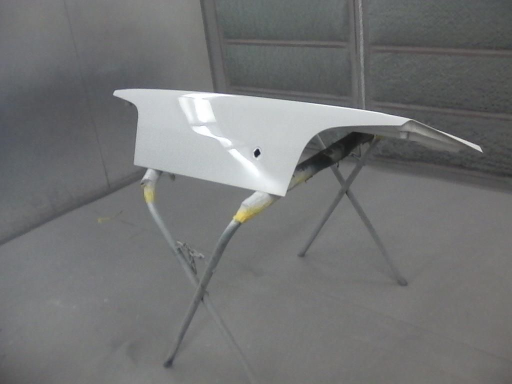

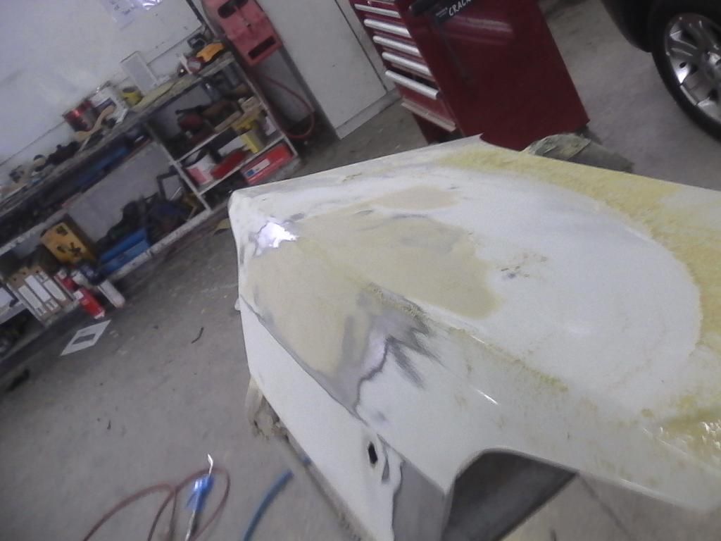

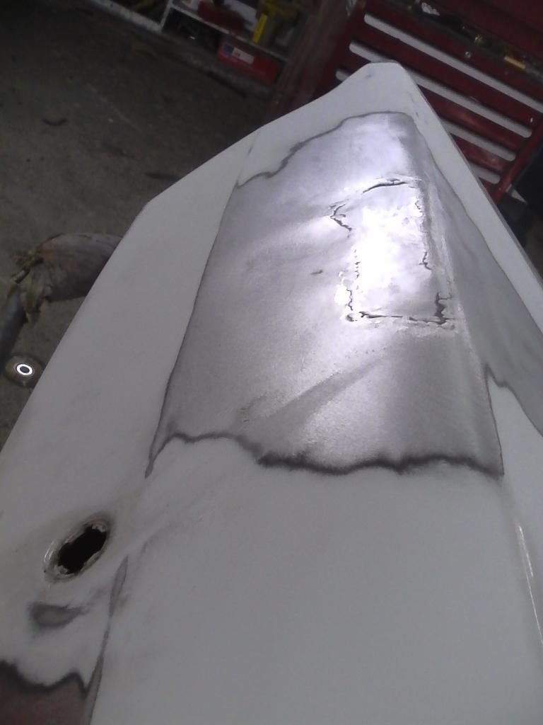

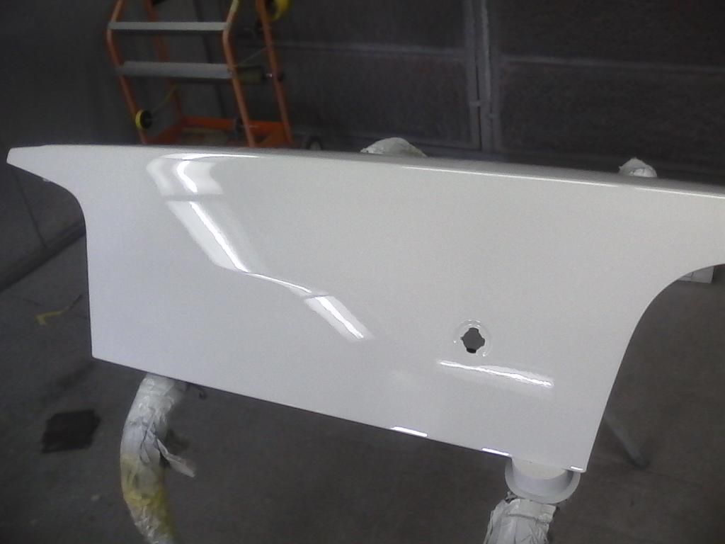

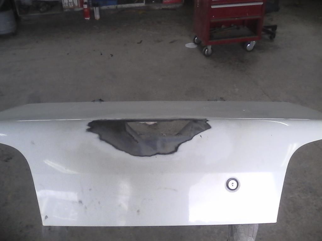

Right, so its been a while since i really did anything on the r34, life gets in the way sometimes. But Ive found myself with a sense of new found motivation and decided to sort something that had been bugging me for a while.
The high stop in the boot-lid. It was starting to rust out and the last owner had tried bogging it and sprayed it with white spray can paint, and everytime i saw it I would cringe.
My original intention was to repair the rust and refit the high stop, but i thought why not make the job a shitload harder and delete it all together from the bootlid and move it to the rear window.
Heres how it went:
The culprit
The rust cut out and a random shape left.
Cut a piece of paper relatively close to the patch shape, trying to account for the overall shape of the boot lid.

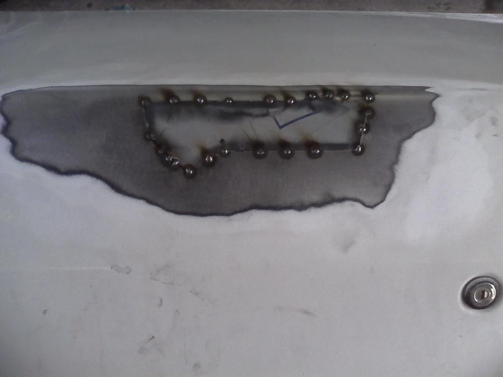

Patch tacked in place, and looking good so far
More tacks, my attempt at trying to keep the heat in the panel down would end up being futile.
Patch all welded inand you can sort of see the warps in the panel below the patch. Fuck it all
Boooooooooooooooooogggggggggggg.
More booooooooooooggggggggggg.
Also welded the bumper back up where the giant canon had melted its way through. The canon is now gone. Yuuuuuuussssss

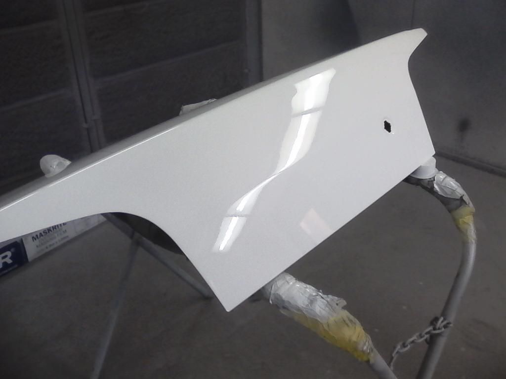

Prime and a block 1
second and final prime, looking pretty good i think
And finally some paint and clear. :D

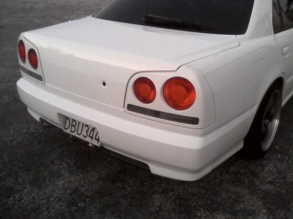

Parts back on the car and i actually like it without the lamp, thanks the entitys that be for that!
